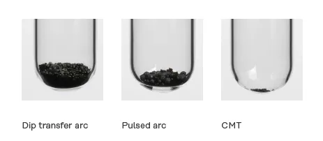

Wherever adhesive or solder was used before, CMT (Cold Metal Transfer) welding can be used instead. CMT has revolutionized welding technology and expanded the range of possible applications with its reversing wire movement.
The back and forth movement (reversing) of the welding wire—at up to 170 Hertz—produces an exceptionally stable arc. This results in a 33% reduction in heat input and a welding speed almost twice as fast as with conventional dip transfer arc.

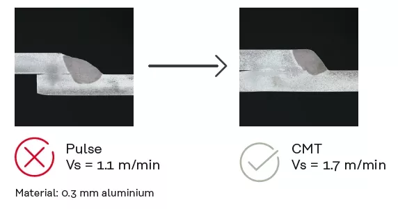

Fast joining of thin sheets

During welding, the wire moves forward and is pulled back again as soon as the short circuit occurs. As a result, the arc only introduces any heat for a very brief period during the arc-burning phase. The result is spatter-free material transfer. The arc remains stable, regardless of the surface characteristics of the workpiece or how quickly the welding specialist works. This means that CMT can be used anywhere and in any position.
Welding does not inevitably have to mean welding spatter and rework. CMT promotes controlled droplet detachment during the short circuit, while the current is kept low. The result is virtually spatter-free material transfer.

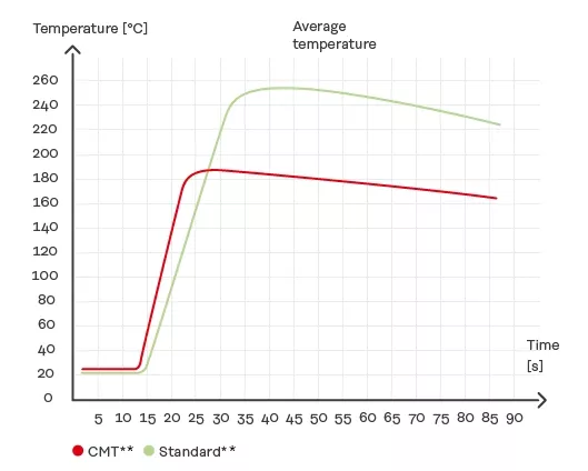

Reduced heat input
*Compared with standard dip transfer arc
Heat input at the lowest level: as soon as the short circuit occurs, the wire is pulled back again during the CMT process. This means that the arc only introduces heat for a very short time.
As a result, CMT enables continuous regulation of the heat input from cold to hot. In addition, higher welding speeds and a wider range of applications* are possible with maximum weld quality.

With CMT, the welding speed can be doubled while maintaining sufficient penetration thanks to the highly dynamic Robacta CMT Drive wire feed unit.
Root Standard
Result with standard dip transfer arc**
Root CMT
Result with CMT at 2x speed**

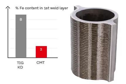

CMT cladding: 75% less dilution of base and filler metals
In conventional overlay welding, the arc fuses a relatively large amount of the base material.
The typical dilution and mixing of base material with filler material reduces the corrosion resistance of the applied layer. However, the base materials are melted to a lesser extent due to the lower heat input of the CMT process. This results in up to 75% less metallurgical mixing of the base and filler materials, and reduces costs for overlay welding.

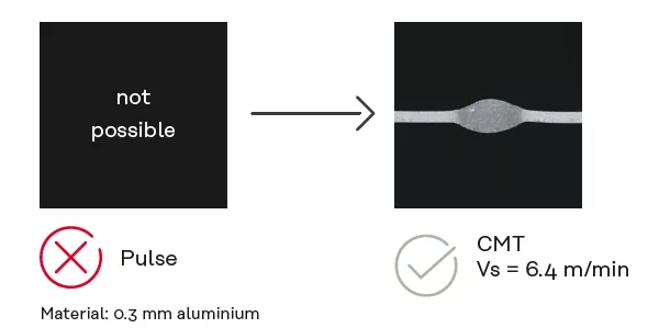

Light gauge (≤ 1 mm) aluminum sheets can be welded.
The low heat input of this process means that weld-pool support isn't necessary to keep the weld from dropping through.
